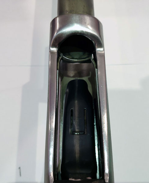

Re: Remington 870 for IPSC

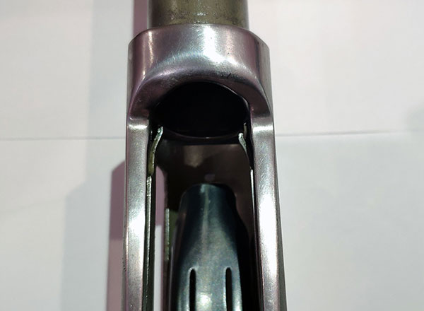

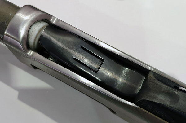

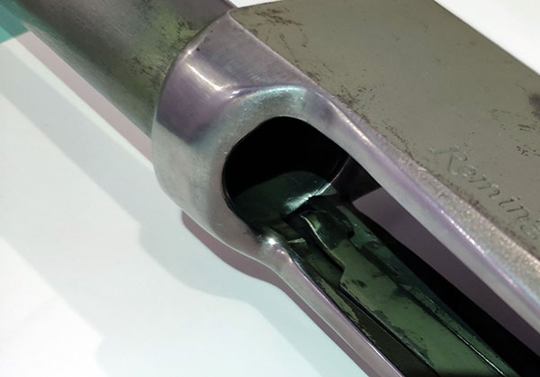

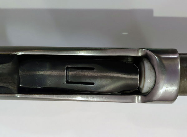

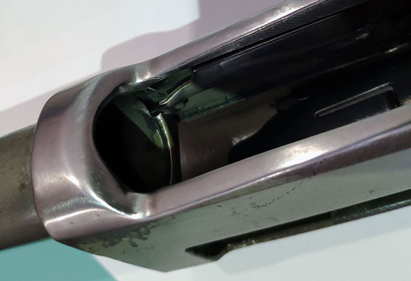

Opening loading port.
- 870_loading_port_modification6.jpg (28.35 KiB) Viewed 57186 times
- 870_loading_port_modification5.jpg (31.24 KiB) Viewed 57186 times
- 870_loading_port_modification4.jpg (33.36 KiB) Viewed 57186 times
- 870_loading_port_modification3.jpg (34.66 KiB) Viewed 57186 times
- 870_loading_port_modification2.jpg (32.64 KiB) Viewed 57186 times
- 870_loading_port_modification.jpg (26.6 KiB) Viewed 57186 times
