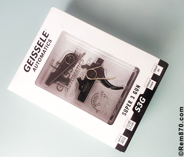

I use Geissele Super 3 Gun trigger. I like it but had several 2-3 round bursts when I tried to pull the trigger slowly.
What trigger do you use and why? 1-stage or 2-stage?
